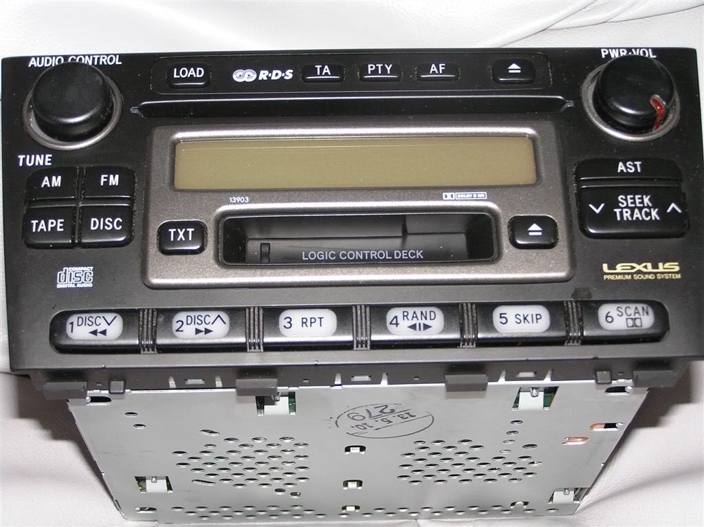

October 22, 2007, 1:11 pm
Check the front to ensure the number buy the cassette slot is the same
ie:- 13904 etc

It isn't cold here, I took the Cd straight from my apartment so no chance of condensation or anything. I only bought the car recently and never used the CD player. There was a lot of dust on bottom lip of the loader which may point to dirt on the lens. I tried a few tricks I read on here like powering it on and off, swapping from radio to cd, none of this worked. I saw one about pulling the unit out but that looks a bit like hard work and no doubt I would damage it even more.

October 22, 2007, 4:16 pm
look closely top left of cassette slot, (you will need the full size pic to see properly)
It says 13903 on this 1 (my old CD Player)
[img]http://i176.photobucket.com/albums/w163/djwozza/Lexus_CD_Player.jpg[/img]
the number must be the same to plug straight in
as the connectors are different I am told.
Hope this helps ya

If it has the CD slot at the top, then it has to be replaced with the same type, same if CD slot at bottom - if you get my drift.

The number is 13904 , it looks exactly like the one in the picture. From what I read around, it only makes sense to replace it with an after market model like Cous3 did. Cost too much to repair and it could break again the week later.
