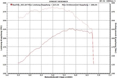

Hy!
227hp on the flywheel and 288Nm is a good run with 0,5bar and original engine.
Dynorun Video
Next steps: new clutch, new tyres, bigger intercooler, modified downpipe with new katalysator, maybe a new boost controller cool.gif

Wow, that pretty damn good. Do you still have the standard pistons and rods in the engine?
As Cho said is that standard pistons and rods?
impressive figures for 0.5bar, well done.
Boergy
yes, the pistons and rods are original. Only the intake manifold is modified, 250ccm Injectors with original petrol system (3,5bar pressure) in the spring, i test again with maybe 0,65bar. i will test with the new intercooler and other things. i think 240-245hp are possible.
