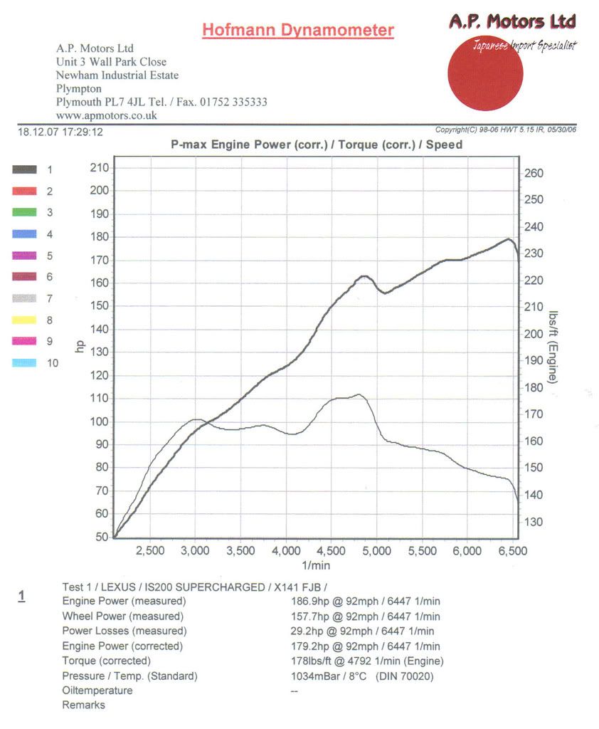

It was on a dyno last night and was a little disappointed to see a max power of 186 bhp! It seems just as it's getting good boost (4psi, dont know what its suposed to make?) at just below 5k revs, the boost drops off copletely and there is a squeel from the charger.
Does anybody know if there is a clutch in the supercharger that can wear out? The belts seem ok, tight and no signs of wear.

See the printout: http://i121.photobucket.com/albums/o227/84stoney/dyno1.jpg

the unit makes 4 -4.5 psi anyway so worries there. there is no clutch in the supercharger so nothing to wear out. The SC unit is from an SLK and has been modified to permanant drive ( SLK uses a magnetic clutch).
I would replace the belt ( PN : 5pk800) and also check the bypass valve on the sc is closing properly - post a photo of the cable adjusters on the bypass valve and also check EVERY pipe clip and hose for correct installation as they do work loose.
also was the run performed in 5th gear?

Not enough pressure on the belt (or old belt), order a new (Contitech) belt and you'll be fine. If you hear a howl or hissing sound at 5000 rpm while pulling through it's definitely the belt (furthermore do a search on te uprated spring and see if the new one is mounted).

To conclude this thread. Had new belt fitted, and seems to hold fully boost right up to redline now - SORTED.
I used a 5pk803 belt, 3mm longer than reccomended (easier to get hold of i found) seems fine.
