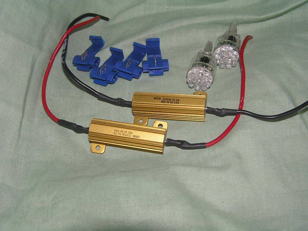

something rather nice came through the post the other day, here's a pic
I from what I have been told these are from an old group buy (organised by Mr.Morse).
They have no fitting instructions whatsoever, so I am after any info from members that have them fitted.
Do they operate as well with normal bulbs or only with the LED's ? (wondering on which is brightest)
Also if there are any video clips of them in operation that would be nice to see. I think on the
Nurburgring trip either Lee-iceman or Sparkystav had them fitted (maybe both ohmy.gif), but I didn't realise
I was getting some through the post for free (many thanks GORD biggrin.gif), so I didn't pay too much attention huh.gif
Any info gratefully received, cheers in advance

cheers for the fast replies fellas, apparently they flash faster the harder you brake.
Are they road legal ? Also do threy work better (brighter) with standard bulbs ?
They only flash when you brake hard so yes they are road legal (new mercs have the same system)
There not necessarily brighter though cause they shine forward (and possibly sideways cant remember) but they dont shine backwards onto the reflecters. but their bright enough.
And yeah both me and Lee have them.

Do you have fitting instructions Stav ?

Wozza...as you have no doubt worked out, i've got them on my IS200. Only problem is the warning light on the dash comes on every now and again as the drain on the LED's isn't so great as the standard bulbs, even with those load resistors.

Not sure what you mean by this, the flashing part is incorporated into the bulbs, so without them they don't flash! tongue.gif
They don't flash faster you brake, if you shake the bulbs you'll hear a clicking. That's the tilt switch, so basically if you brake hard enough for that switch to be triggered, it flashes, otherwise the lights come on normally.
As the rear reflector on the IS works via light reflected off the back of the housing, I put these bulbs on and then took them straight off as there simply wasn't enough of a difference between the brightness of the sidelight and brightness when the brakes were on. Others may disagree but I didn't want to take the risk (having already been seriously rear ended once before).
There really isn't much to it in terms of installation, simply replace the bulbs with the new ones, and stick the load resistor between the wires going to the brake light and you're done. You don't actually even need the load resistors, they just stop the "bulb out" warning light from coming up on the dash.

also as for installing i just used that picture Tango put up.
