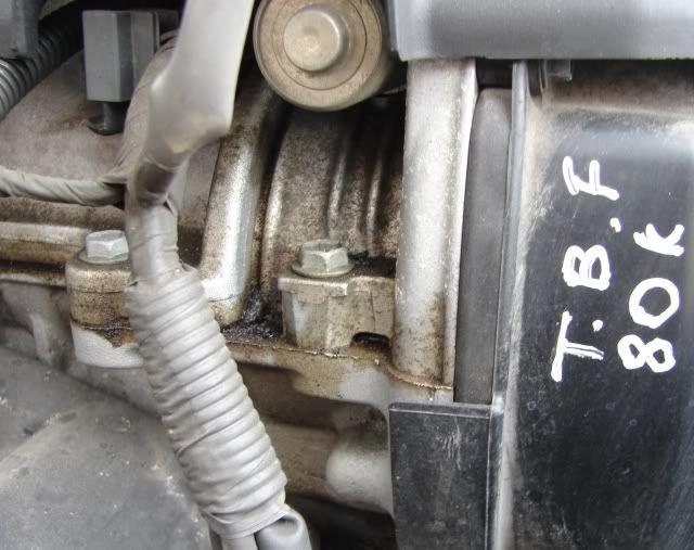

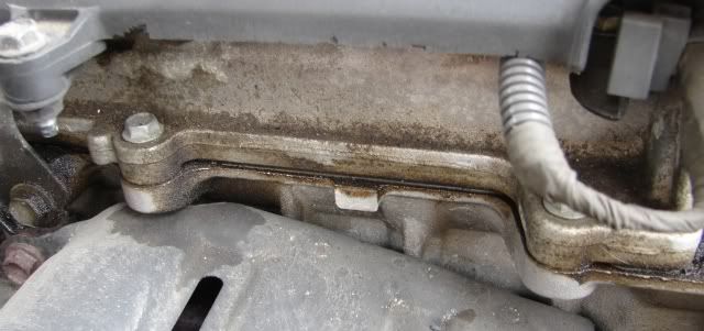

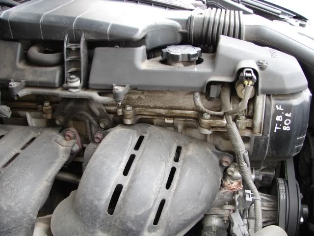

Hi all!
Recently noticed oil marks around the gasket. The oil level is the same but theres more and more oil on the engine itself.
Any reason to worry?
Plus- Theres this buildup on the waterpump or whatever that thing is..
What to do?
Please see the photos and thanks in advance.
Talisker
If it is your gasket that is leaking it could mean the oil and the coolant is mixing and emulsifying which might explain your pink build up around the pump. This decreases the effectiveness of your coolant, heating up your engine and exacerbating the problem.
If caught in time, this shouldn't cause long term damage to your engine, but your gasket should be replaced asap and your engine and coolant system flushed to get rid of any contaminants.
A second opinion is welcome form other members and please correct me if i'm talking b***ocks.
Steve_D
That oil is leaking from the camshaft cover, pretty sure mine has a few tiny weeps here & there, its not the head gasket so not to worry, just give it a clean with a jetwash & keep an eye on it & oil level, looks like your bypass water pump pipe seals are leaking, give that a blast too & keep an eye on it & your coolant level smile.gif

Thanks for responding. Its due to be serviced anyway. Just thought maybe need to service it asap.

as durrantie says its the elbow above the water pump thats leaking smile.gif
