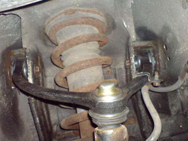

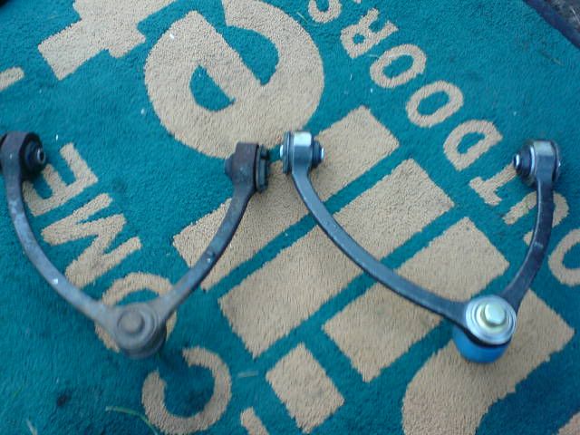

Hi All...
Just remembered, I took a couple of pics on my mobile when fitting said £61 upper control arms...
Sorry about the quality, camera on phone a bit iffy!
As I said before, fitting was easy and the quality of the part seemed fine.
Learned a few tricks on how to fit them quick too in the process!
God bless e-bay!

thermoacc - Brilliant pics, thank you very much.
