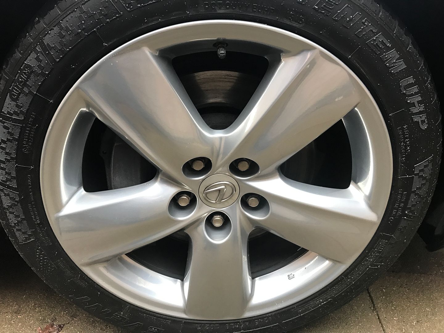

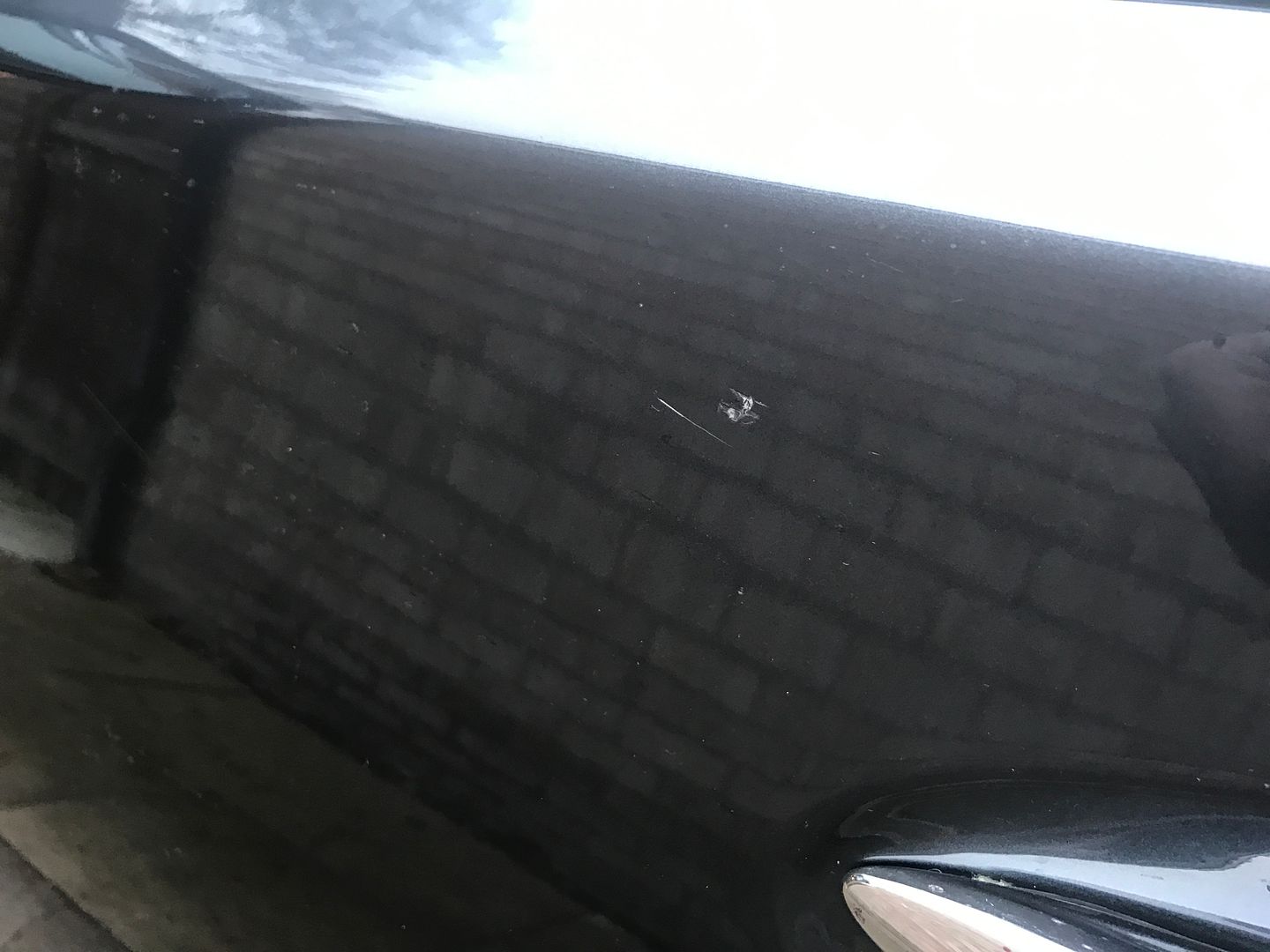

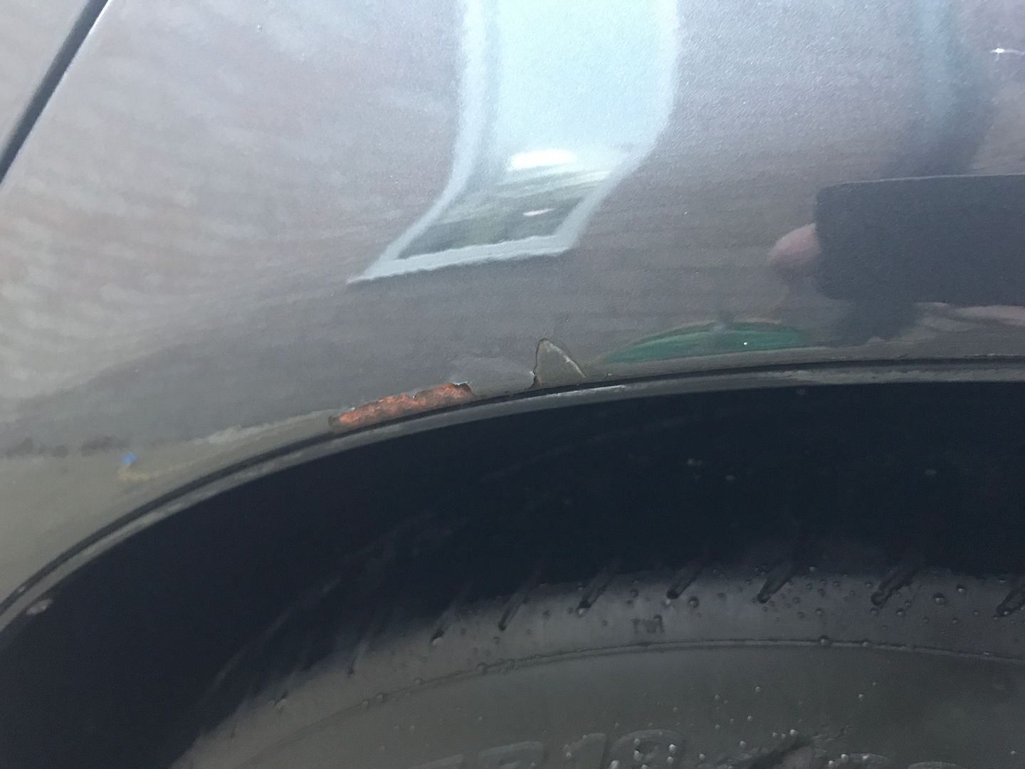

Given it a wash this morning to establish the condition of the bodywork, it has been parked near a railway for some time as the paintwork feels like sandpaper, it has train brake dust etched into it, on the whole though it's in very good condition, there is a scratch on the rear arch that has gone rusty, slight damage to the rear bumper near the exhaust and a nasty chip on the passenger door, the front bumper has been well painted recently as it only has three stone chips I can see.. The switches on the center console are worn on the edges and my OCD won't like that...!!!
Photo%2022-01-2017%2014%2006%2008_zpsxmwPhoto%2022-01-2017%2014%2006%2024_zpsxwwPhoto%2022-01-2017%2014%2006%2039_zpsjyx Photo2022-01-2017201320122004_zpsxynqix7

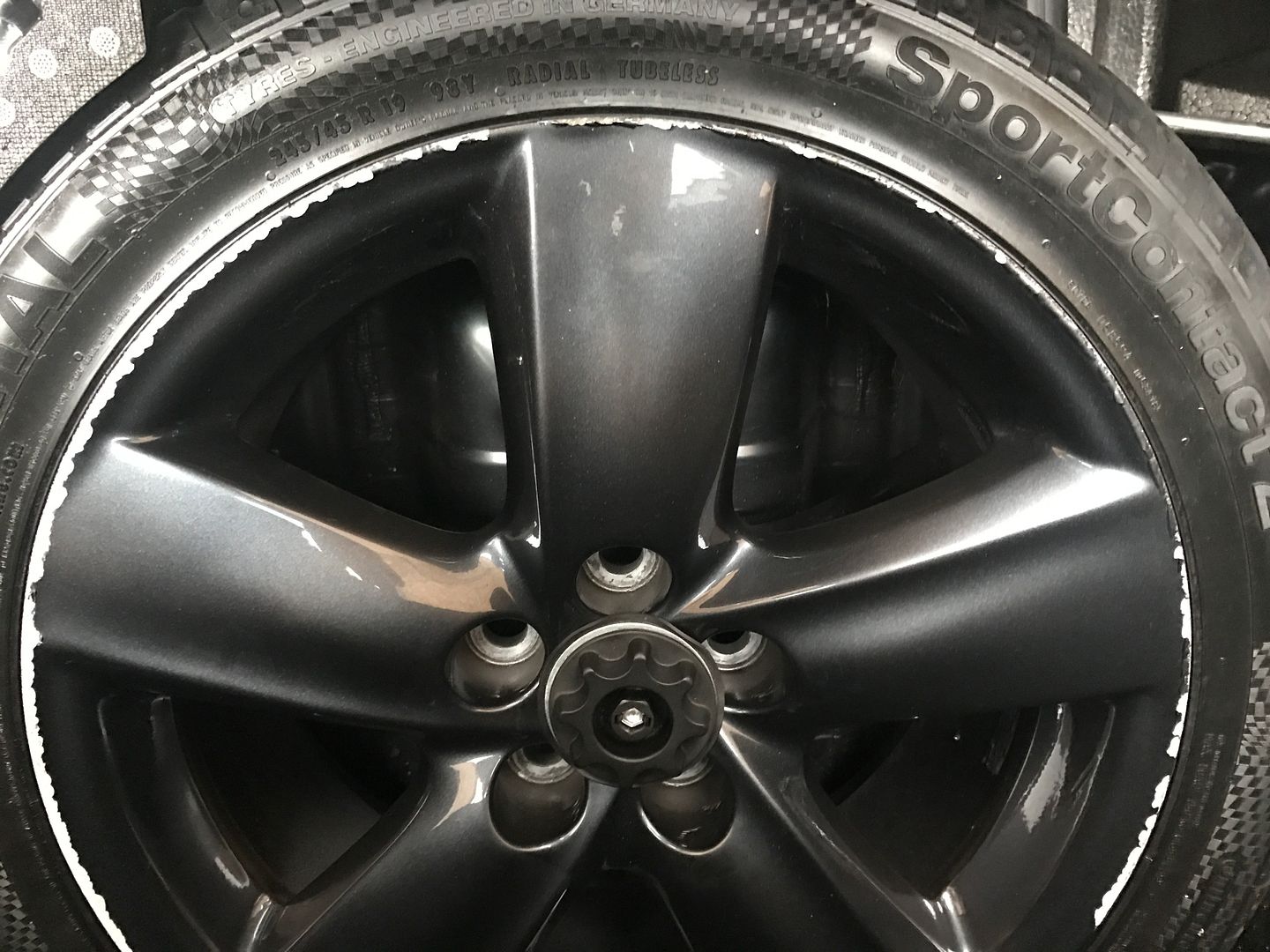

The wheels have been nicely refurbished in smoke chrome
Photo%2022-01-2017%2014%2013%2007_zpswei
The spare indicates what they would have looked like... colour coded and scuffed..... nice...!!! NOT..

It either never had, or someone removed, the locking wheel nuts, that's saved me a few quid in new nuts as I always throw them away when I get a car, IMHO a total waste of time and just cost a fortune when some garage monkey overtightened them
The only other things of note I have found is that the trip computer display doesn't display a value for any of the values that rely on it knowing how much fuel has been used but does work on the time and mileage ones... also the gear selection display is always blank, maybe this is something to do with the new MPH dash... Or does anyone have any ideas...
The Battery retainer is not attached properly and is flapping about and most of the plastic clips that hold the under bonnet panels in place, are missing...
All in all well pleased with it, I'm looking forward to knocking it into shape...

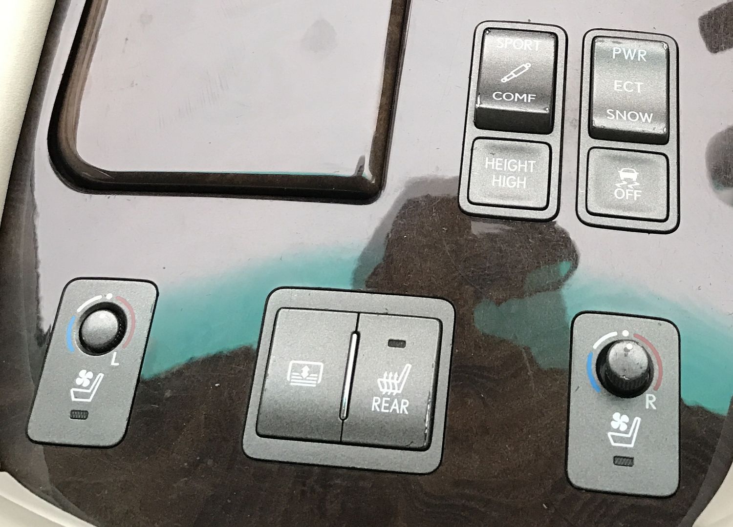

Just been looking on eBay and managed to get all 8 center console switches, which looked in mint condition, for £80 delivered.
I looked on lexuspartsnow.com and one heated seat switch is nearly $200, so I'm pleased with that....

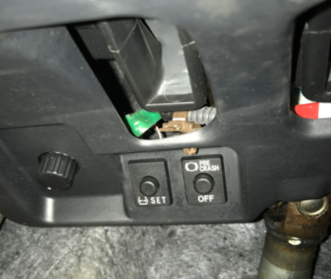

Onto this morning... was wondering if mine had the PCS (Pre-Crash-System) as it has the laser cruise, I did think about trying to run into the back of someone but thought it's probably not a good idea...!!!! Anyway, looking under the dash above the pedals reveals all....
Screen%20Shot%2001-23-17%20at%2001.55%20
The knob on the left is the volume control for the door open/lights on etc beep, the SET button is for the TPMS (Tyre-Pressure-Monitoring-System) and the pre crash off is to turn off the braking assistance in the event of an unavoidable accident, there are various levels of the PCS system, it appears mine is just for me crashing and not being rear ended as I don't have a rear sensor behind the bumper...

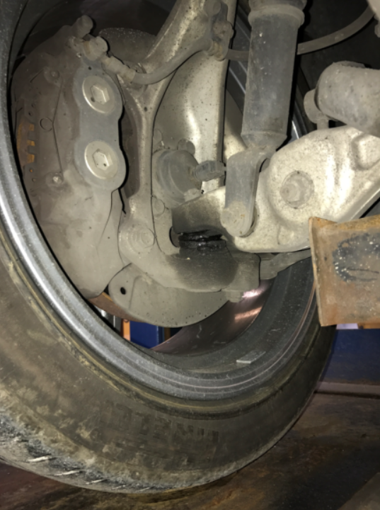

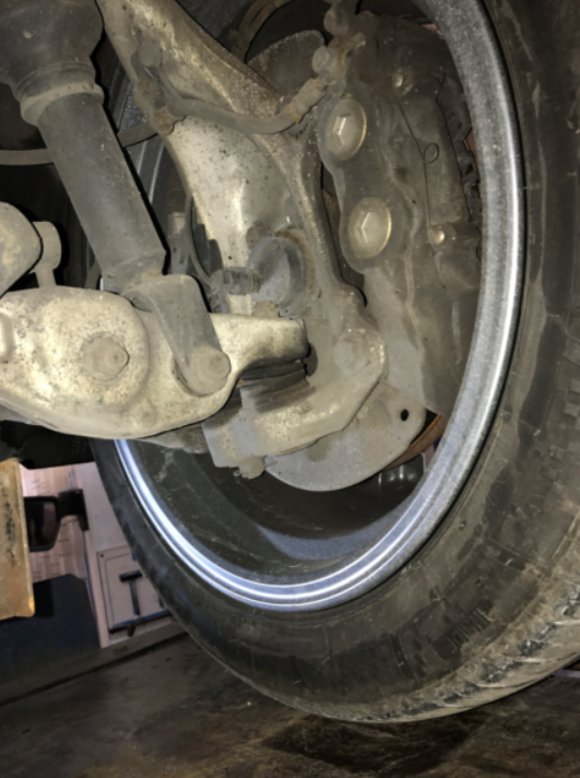

It was then time to get it on the 4 post ramp and check the front suspension and brakes all round...
The front nearside lower arm ball joint boot is split..
Screen%20Shot%2001-23-17%20at%2001.58%20
The offside is misting but not failed yet...
All four upper arms are showing signs of bush deterioration.
All four discs are well worn with big lips, no misting or leaks from any calipers so that's good...
So the plan is to change the lot
New front discs and pads
New rear disc and pads
Four new upper arms
Two lower arms
Two lower control arms.
I can source ADL Bluespot brakes and PowerDrive (OEM manufacturer) arms for £698.31 for the lot.
We gave the rest of the underside a good look over and all appears to be well. Whilst I'm doing the above it will have new oil and filter, new spark plugs. I also plan to change the gearbox oil and filter and the rear axle oil, I shall change the brake fluid as well and drop the coolant and renew it. Air, fuel, aircon and seat filters will also be changed and it should then be good for a while...

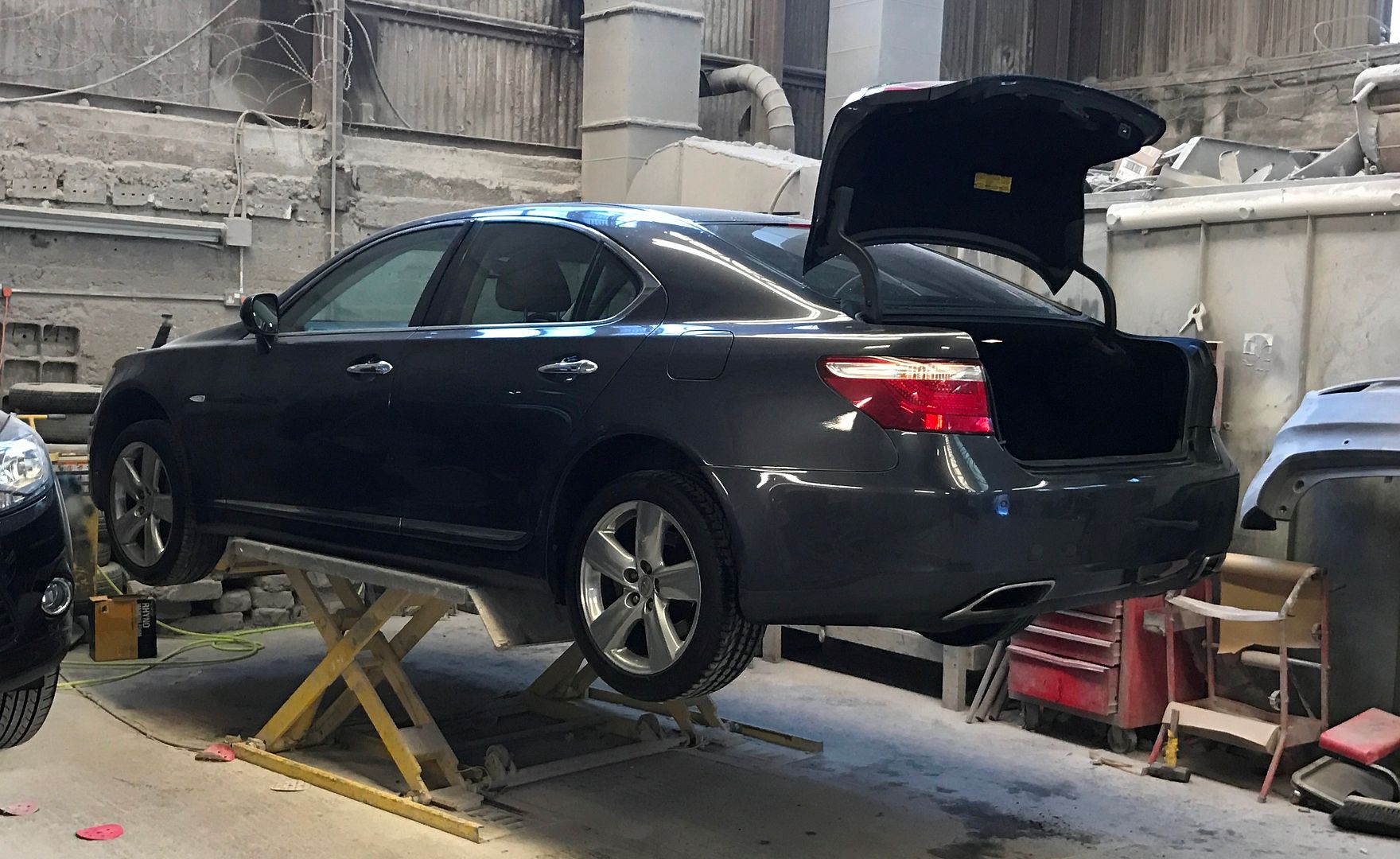

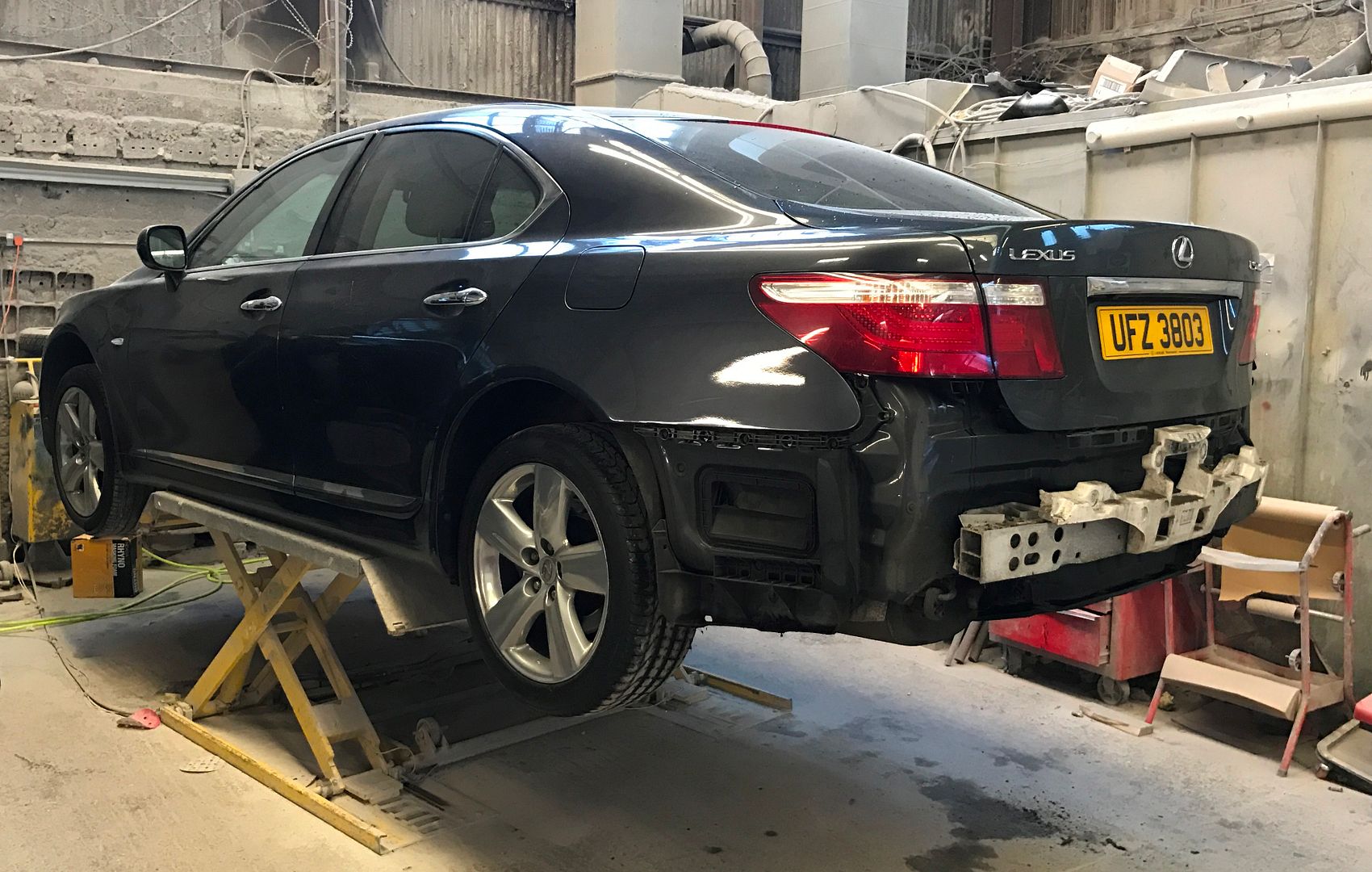

Whilst I'm waiting for that lot to arrive I popped to the paintshop... they are having a quiet week... we had a good look at it under the sunlamp, it has had various panels painted before, nothing appears to be from serious damage, this and the few marks it has round it means both sides and the rear bumper will get repaired and painted.
They soon had it up and on the scissor lift
Photo%2023-01-2017%2011%2019%2002_zpswiq
And 10 mins later the rear bumper is off...
Photo%2023-01-2017%2011%2053%2058_zpsvjh

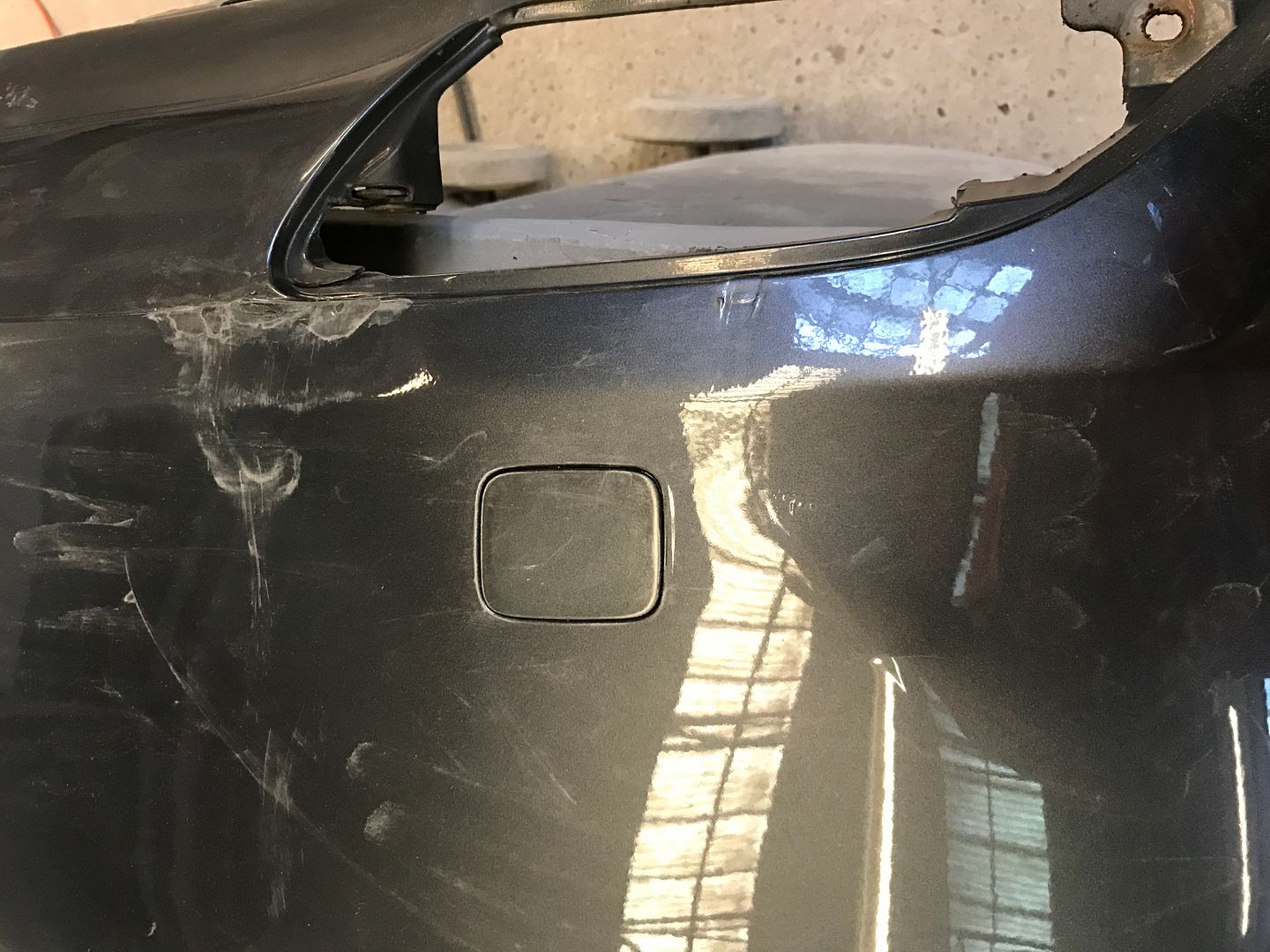

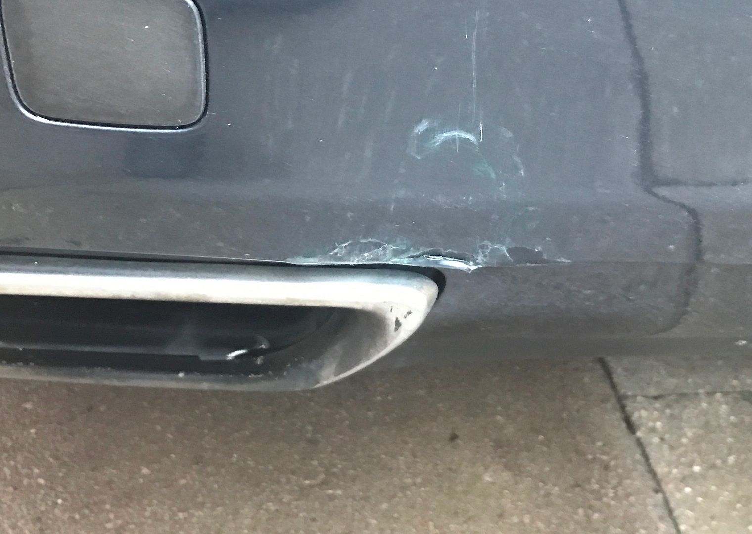

It's lost a small piece of the polystyrene from the bumper support where it was hit by the tailpipe... The rear PCS sensor would be fitted in the bit of polystyrene that goes up in the middle, there is certainly nothing there so I just have the front system...
The damage to the bumper came out with some heatgun use...

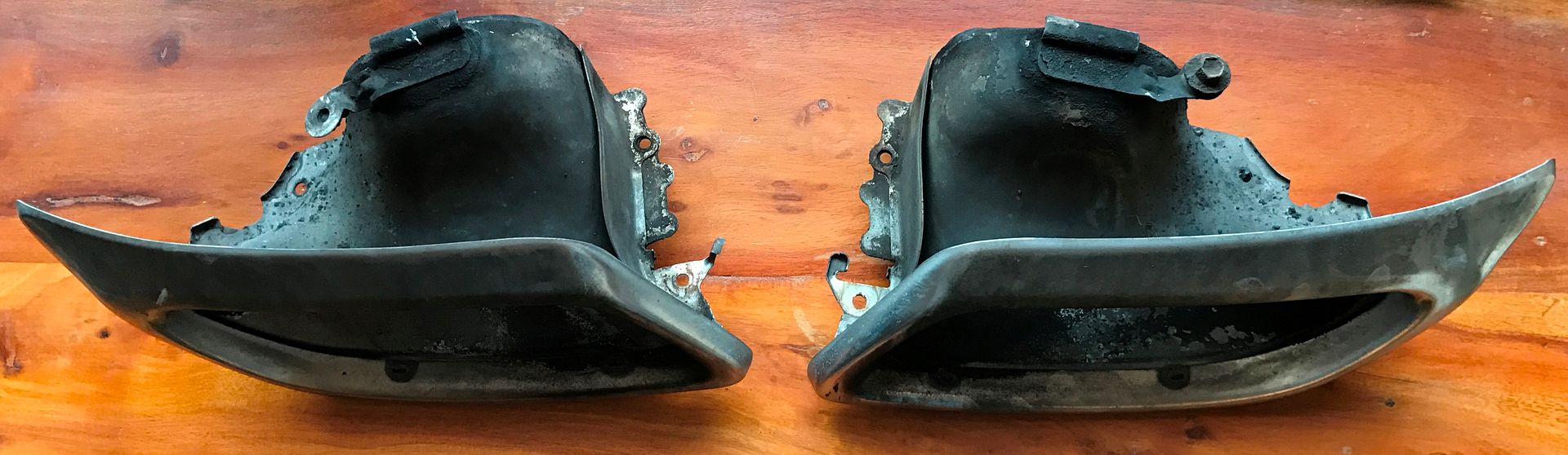

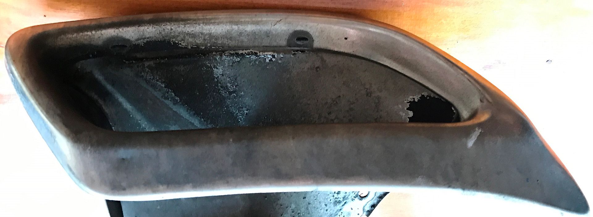

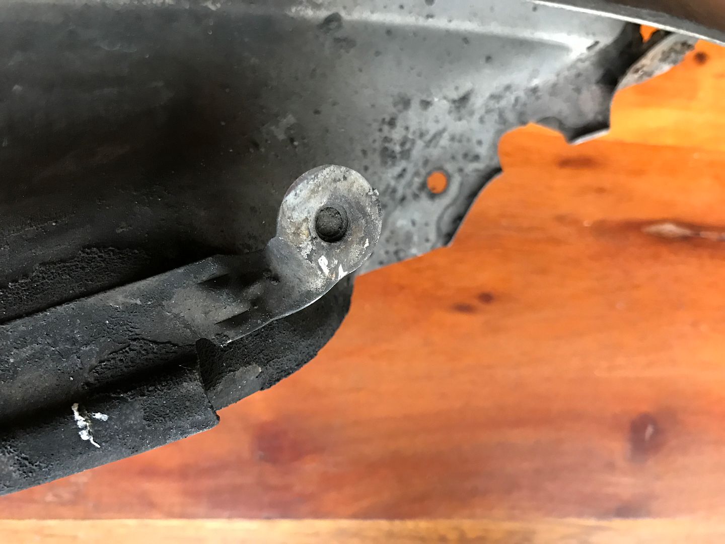

The exhaust tips are fitted to the rear bumper, they don't actually touch the exhaust, they are fully stainless steel but were fitted on with mild steel bolts, these all snapped so I brought them home to drill and tap and give them a good clean up...
Sheared bolt...
Photo%2023-01-2017%2014%2027%2053_zpstho
They need a good clean up...
Photo%2023-01-2017%2014%2027%2029_zpsse4
Photo%2023-01-2017%2014%2027%2043_zpskil

In hindsight my logic on the bolt was misplaced as the only way it would have been needing replaced would have been in a replacement or repaired bumper in which case a new one would be required.
