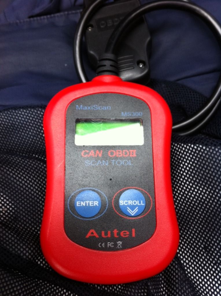

Its a Autel MS300 it work on the LS430 our RAV4 my landcruiser . I have also used it on Jeeps and VW
Looks like this
Cheers - was looking at the Autel 509 - so may take the plunge
Looks like this

I bought this one. Its laptop based and worked with lexus IS220d when I needed to clear my airbag codes and nothing out there would do this. works only with XP. more info on http://garageforum.co.uk/forum/148-toyota/53369-toyota-techstream-700020-22012.html
Reporting back and I can say its bloody marvelous. 10 secs to do the scan which showed no problems, already fitted new MAS told it to erase the engine management light which it did instantly.
It took me 15 mins to find where those crafty Ford designers had hidden the port, my wife helped them in their efforts to thwart the honest man in the street doing things for himself by leaving a pair of slippers in front of it.
So in conclusion why haven't you got one yet?????
