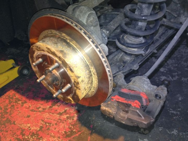

Oh my dust boots are well and truely covered! They are a little fiddly to re-fit once off, as I added grease to the slider, getting the boot located over that meant it was caked hehe!
Heres some more pics of the brake disassembly for those that aren't quite sure.

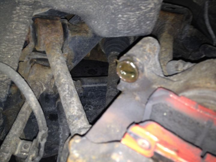

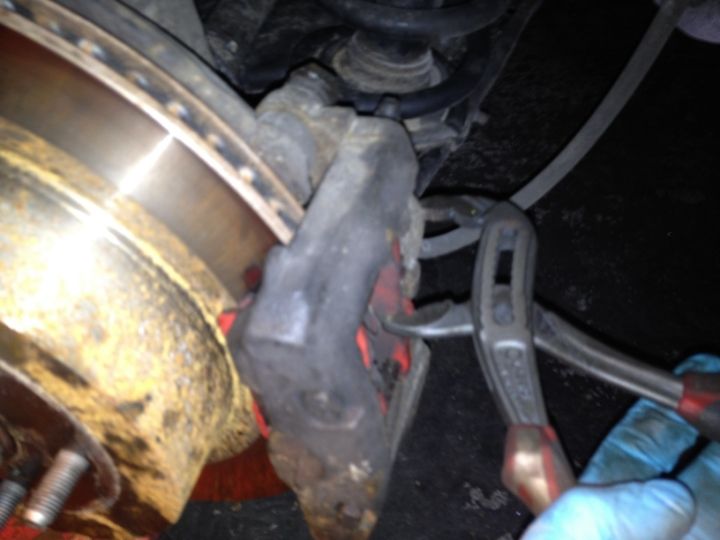

Gently squeeze the piston back using a pair of pipe grips on the old brake pad if you haven't got the correct wind-back tool (like me). Make sure the piston is flush with the calliper body or you won't get the new pads in.

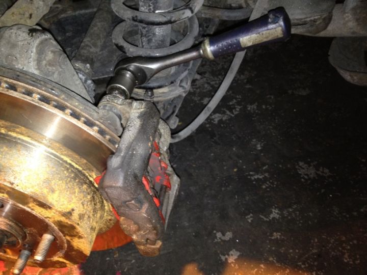

Using a 19mm socket undo the top slider and pull it out completely.

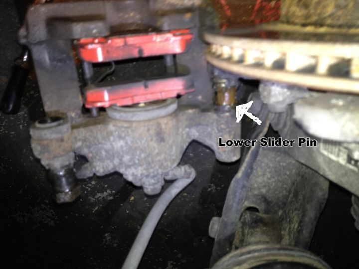

Then fold the calliper over like so. (note the lower slider pin without the dust boot!)

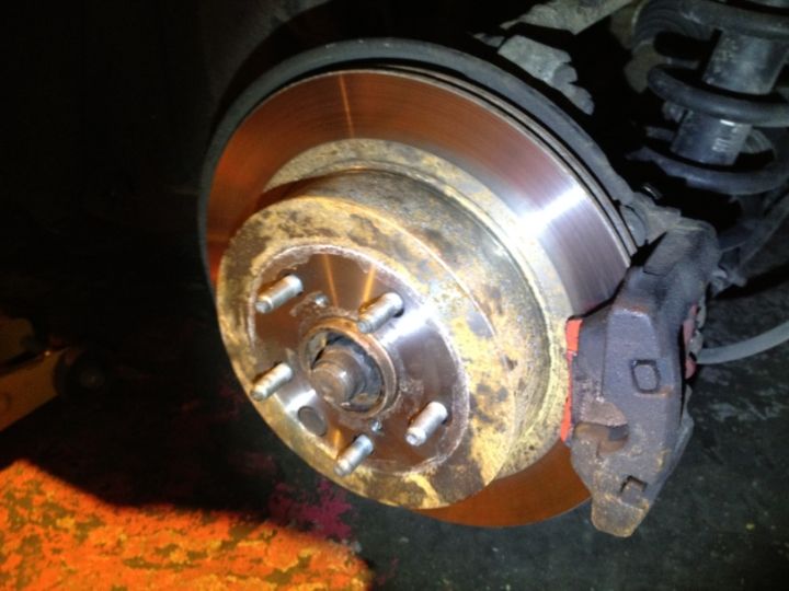

The calliper should then slide off of the lower slider pin so you can tuck it out of the way to replace the disc (if needed). It also gives you nice access to the lower slider pin to enable it to be cleaned and thoroughly lubed.
Birds eye view

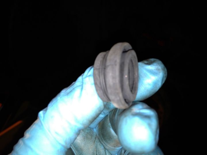

The ominous lower dust boot (circa £4 from Lexus, it had come all the way from Belgium for me!)
Oh and a picture of the hole that the lower slider fits into on the caliper body (with added grease)
Hope that makes things a little clearer. The pads are easy to remove, just remember to put the calliper back on before replacing the pads as it's a whole lot easier :)
