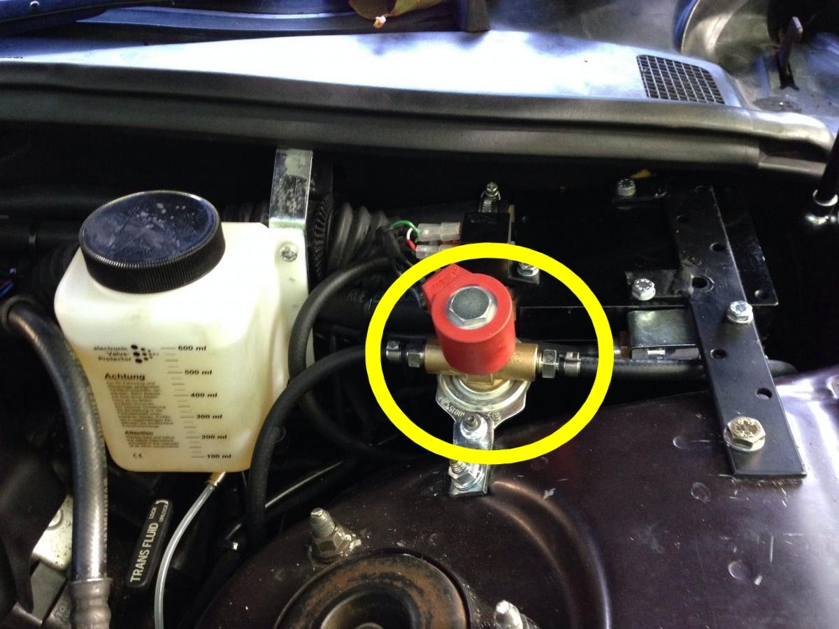

There seems to have been a fair bit of drilling of bodywork been done, especially strut tops. Also not the neatest install.

I would be crying my eyes out if that was my car ,there does not seem to be any planning in the routing of the system and it all looks a bit amatuerish. The loss of the tool box holder the awful filler cap on the wing panel the less than thoughtful fixing of the engine bay components.And to top it all the ridiculous MPG.

Drilling into the suspension leg fitting area is just crazy and I would have thought dangerous as it has now compromised the integral structure of that part of the chassis.

Please clarify guys, do your cars have the coolant reservoir bolted to the offside strut bulkhead?
If so then maybe it's not to much of a problem if other elements are mounted in the same way?

Its location is not the problem. The problem is that it is held on by small clips that can easily blow off at pressures over 2bar
If this is the case then I would NOT drive the car at all and keep away from it.
However it could be totally inocent and its the solenoid for the flashlube to only inject it whilst on gas. If this is the case then that is perfectly fine.
