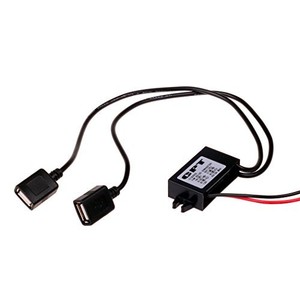

I hard-wired a USB power converter like this so the accessory socket is still free.

Yes, but I don't think the USB sockets give out enough power for devices.
The camera I have came with standard USB cables (allow pc connection) so the converter I used was the best option.

This is the dash cam.
https://www.amazon.co.uk/gp/product/B012CMUYXQ/ref=oh_aui_search_detailpage?ie=UTF8&psc=1
It has a USB micro port for power on the GPS base and one on the camera to allow you to connect it to a PC to download the video files. I remove the SD cards to copy any files.
You are wrong about dash cameras being 12v. Yes, they connect to a 12v supply as that is what the car provides, but you will most likely find that your accessory plug adapter that came with the camera reduces the voltage down to 5v. There is probably a sticker on it showing the power. For anyone piggybacking off a fuse, I do hope you have not just cut the cable from the cigarette plug and wired it straight in. You will eventually kill your dash cam.

The easy way is to wire a 'trailing' female ciggy socket to the piggy back fuse, and plug the supplied ciggy plug into this.  Then hide this connection either above the fuse box if there's room, or behind fascia/dash trim.
