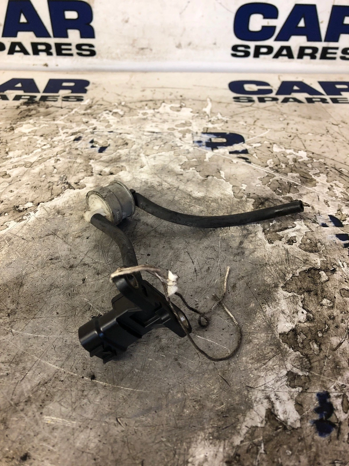

Hi Adam,
Yeah, if you look at the pictures posted, the one I mentioned does appear to be for the EGR cooler.
Sorry, but it has been so long that I can't remember exactly at what stage you are currently at :smile:
