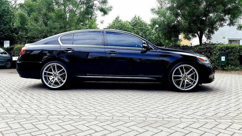

Currently has some lairy big 20inch rims and skinny tyres. Are OEM wheels easy to get hold of?

The only advantage I have is that I do not know what the ride is like on stock wheels. Feels ok on these to me.....if I avoid pot holes!
It gets worse. Calipers are painted yellow!

The wheels do look great, but I think they will destroy the ride comfort.
Wheels to look out for that are virtually the same specification as the OEM are Mazda RX wheels. There are plenty on the market making them cheap to buy because of the rotary engine problems causing cars to be scrapped. They do require spigot rings because the centre bore is different "larger" but they are 81/2 J x 18" with the same stud PCD as the Lexus wheels.

After two weeks and not many miles I have a slow puncture in one of my crappy tyres. As rears are 280 wide and a bit over circumference they show signs of rubbing.
Decided to keep the 20 inch wheels as they do look nice and are solid forged aluminium so should not flake like stock wheels do.
However, I will maintain as close a rolling circumference to OEM as possible. Will have to be 245/30 R20.
Going to spend big on tyres. Cannot bring myself to buy Landsail at £80 a tyre fitted.
4 bits of quality rubber are going to to cost the best part of a grand.
