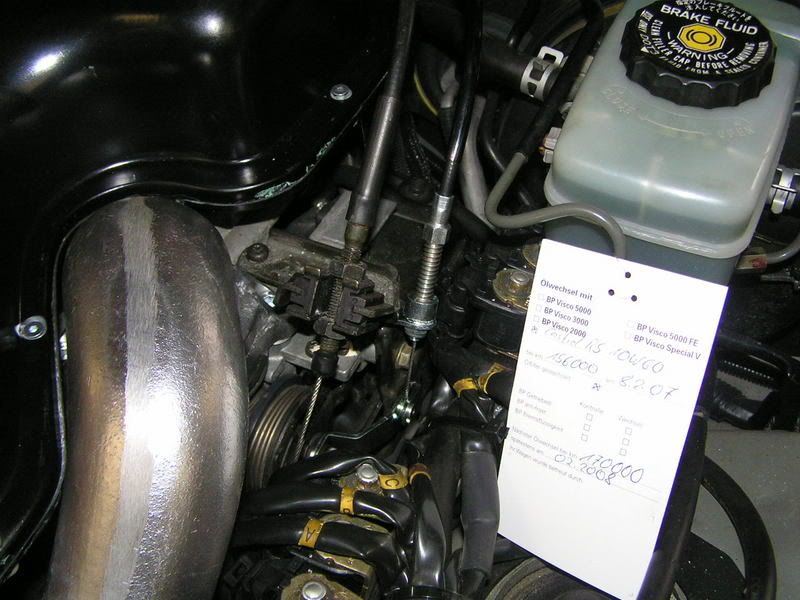

PS: Something that is strange is that the bypass looks slightly different from what I know from TTE Bypasses. There is a different spring installed. Not the same like on my supercharger...
Put up a pic of the spring. Was the s/c brand new or second hand? The problems that people have had with the s/c were mainly due to the piggy back ECU. Especially if the kit is second hand. I think Gerhard had a similar problem after I sold him my S/C. Again it was due to the ECU

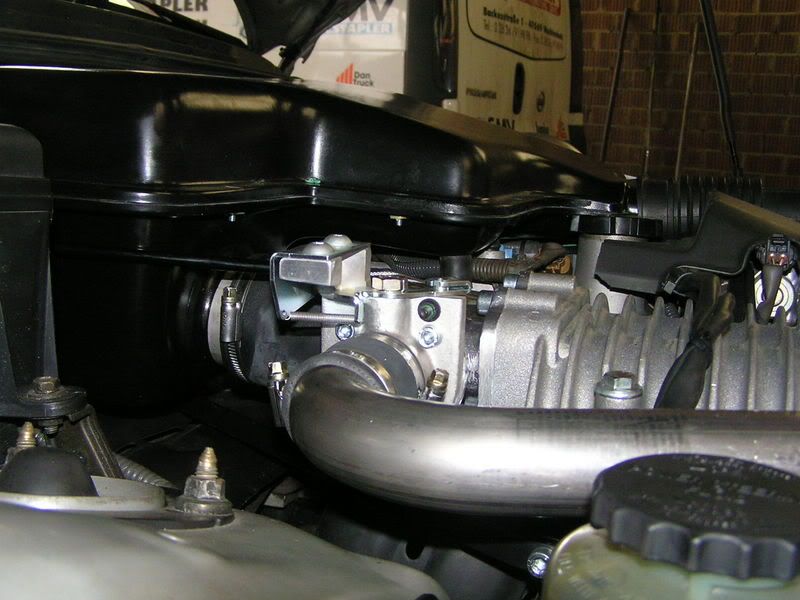

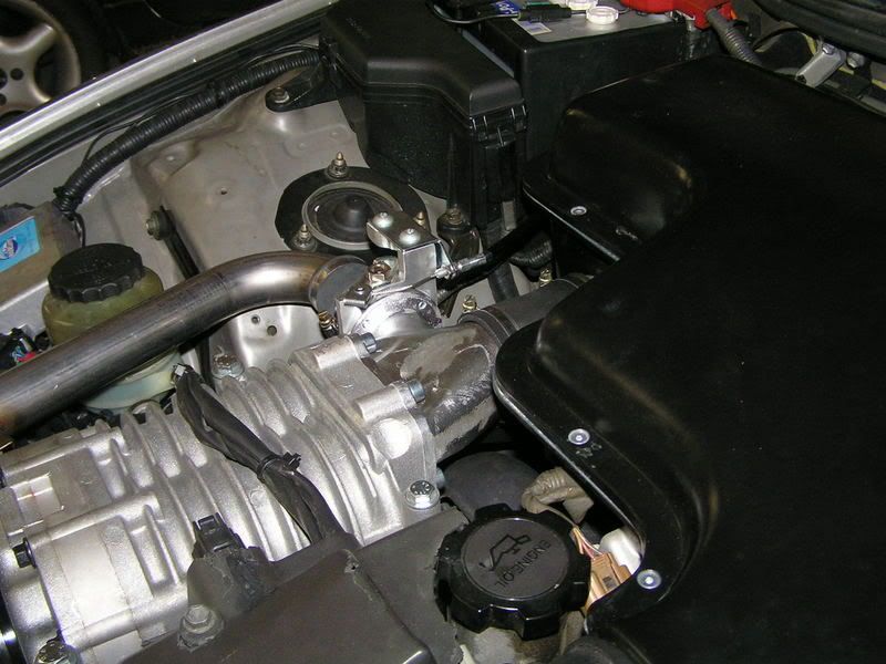

Will post a pic of the bypass as soon as possible...
Pics... from what I know: This should be the first generation bypass-spring-system (what a word)..
He told me that it made no difference whether to tighten or lose the bypass cable.. it always does a powerloss at 4000rpm..

I would also run the cable underneath the supercharger
awaiting a reply from TTE. Thanks for the comments :)
The cable is from a (so far) disconnected LPG-system. It is a bit too short to run underneath the s/c. But perhaps it will be fixed during the next months..

let us know how the car is after the new black ECU. your bypass cable adjust is a little bit forward than it should be ( according to TTE) but I dont think it will make any real difference.
Oh! did you get the new type of spring also???
the nuts should be as far up the thread as possible - TTE say this is because if the adjuster is at the other end - ie a tighter cable then this "could" extra load on the throttle servo and then you will get a power cut and the associated eng anf trc lights on the dash......... this happened to a newish member a month or 2 ago i seem to remember.
Out of curiosity i put mine to the other end so the cable was at its tightest and i didnt get any warning lights and i didnt really find it made any difference to the car performance either.
