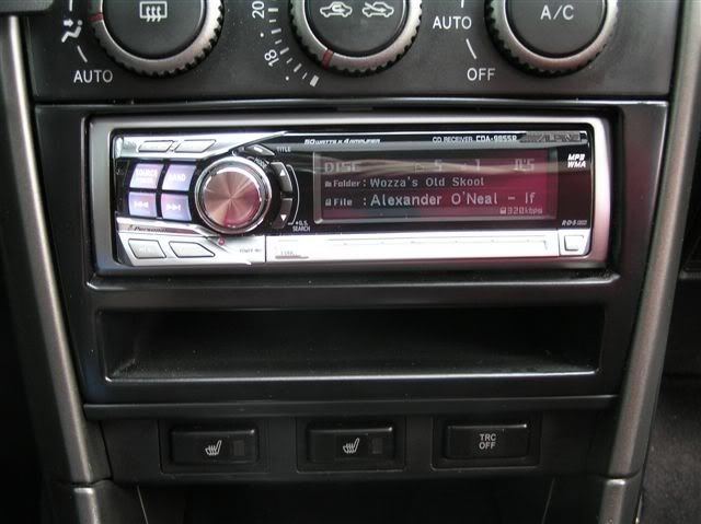

Finally MINE'S ALL FINISHED :D
Head unit was replaced, & so were the speakers
Front + Rear. I took out the Amp as extra weight
and didnt want it sitting there draining the voltage.
Don't know if it would drain voltage, but wasn't too
much hassle to remove it. All my speakers are
powered by Amps in the boot, via 3 HQ RCA leads
so didnt need standard connector, so all I needed
was Power, Ignition, Earth + Aerial cable.
Doddle !!
I also Sanded and Painted the Double DIN housing
so it matched the dash better ......
The Autoleads housing (same as ebay ones) that can
be modded to take Double DIN or Single DIN comes
with a rough bobbly finish thats also too glossy.
Here is an UN-Modded kit for single DIN.
The bottom section with the silver and black boxes will
not be there on yours as it will be filled with the Double DIN
Head Unit. Look at the finish ..
