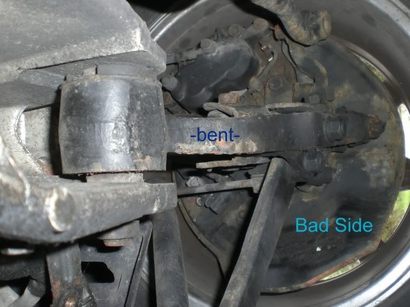

OK guys, here are a couple of pics which hopefully should show the problem...
When I feel a little more enthusiastic (and fixed all the outstanding faults), I'll try and get some nice shots of the car itself.
http://i146.photobucket.com/albums/r243/clever_dick/CIMG1537.jpg
http://i146.photobucket.com/albums/r243/clever_dick/CIMG1534.jpg

Right then, just in case anyone's interested, here are a few more pics which hopefully should show the problem quite clearly. Still can't imagine how it happened though! (The previous owner says he doesn't know anything about it, and I do actually believe him!) I'd be interested to know how many turns of thread should be visible on the strut bars - and, providing it's equal each side, is it that critical?
More importantly, just how easy is it to replace the lower arm?
I can't believe I fell for this one (having checked every other thing on the car)!
One thing to add to list of things to check when buying a car: "Compare wheelbase each side"!
http://i146.photobucket.com/albums/r243/clever_dick/Straightarm.jpg
http://i146.photobucket.com/albums/r243/clever_dick/Goodside.jpg
http://i146.photobucket.com/albums/r243/clever_dick/Bentarm.jpg
http://i146.photobucket.com/albums/r243/clever_dick/Badside.jpg
