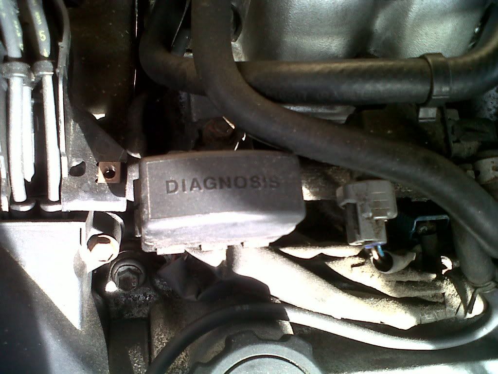

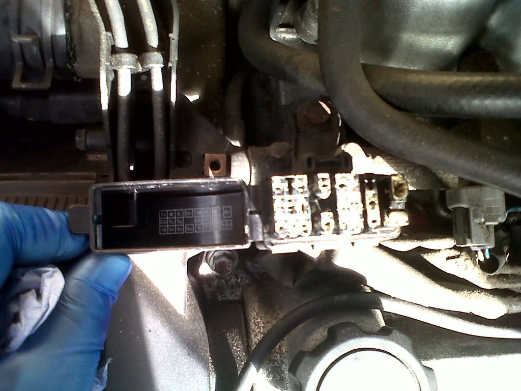

As far as the diagnostic codes for the gearbox go, I connected Te1 and E1 in the small round socket in the drivers footwell, the result was the check engine and ECT Power lights just flash on-off-on-off with no codes.

3. connect Te1 and E1 in the car or on the engine connection blocks.
4Read the diagnostic code indicated by the number of times the O/D OFF indicator blinks

I have found another port for diagnostics underneath the engine cover, see pics:
...Could this be OBD2?
There is the normal round port under the drivers side panel near the pedals and this is the one I have been using to check for codes by shorting TE1 and E1. I assume the garages I have been taking it to are doing the same thing, they have referred to various codes for oxygen sensors, etc.
Does this look like a ODB2 port?
