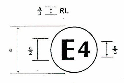

Well to be 100% legal apparently the headlamp which is retro fitted for DRL should be E marked thus
From the legislation
"There is no requirement to retro fit DRL on vehicles not fitted with them as standard. If you decide to retro fit DRL you should ensure they have been approved to the correct European legislation. This can be confirmed by checking that the approval mark embossed on the lamp contains the letters "RL"
Then again I cannot see an MoT tester going into such detail :shifty:
