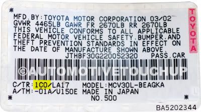

It should be on the VIN plate in the engine bay. Not part of the main VIN number but the first 3 characters of the Colour/Trim code

It should look similar to this, paint code highlighted in yellow in picture.

It should be located on the drivers side inner wing if not check on the door openings and along the bottom edges of the windscreen.
