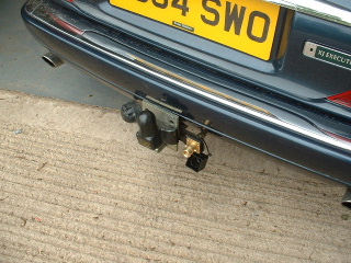

Mine is under the rear bumper. It does mean I have to kneel down behind the car to connect the LPG hose when filling the tank, but I have a small mat for that. The connection is all but invisible.

The recommended Fixed Bayonet Filler (centre of picture) is mounted on a bracket fitted to the rear bumper on this car. This is one of the only positions that will conform to regulations but remain easy enough to use. A coil is put in the pipe to prevent it rupturing during a rear - end shunt, but even if it pipe where completely severed the multi valve would stop any significant (large scale) leakage. All that can happen in that case is the escape of pipe content since the last fill, rarely more than 30 or 40 millilitres.
NOTE that filler points have to be mounted no less than 250mm (10") from any part of the car's exhaust system. This means that cars with twin exhausts cannot have a filler mounted on either side of the rear bumper."
Mine is under the rear bumper too.
It is held horizontally by a strong L shaped bracket screwed into the floor.
I have painted the bracket black and it has a black press-on fit plastic square cover over the filler to stop any ingress of dirt or water. You can buy the covers from Tinley Tech. With a black cover and black painted bracket, this makes the filler more or less invisible.
I have a very similar arrangement. It means the bodywork remains unblemished.
